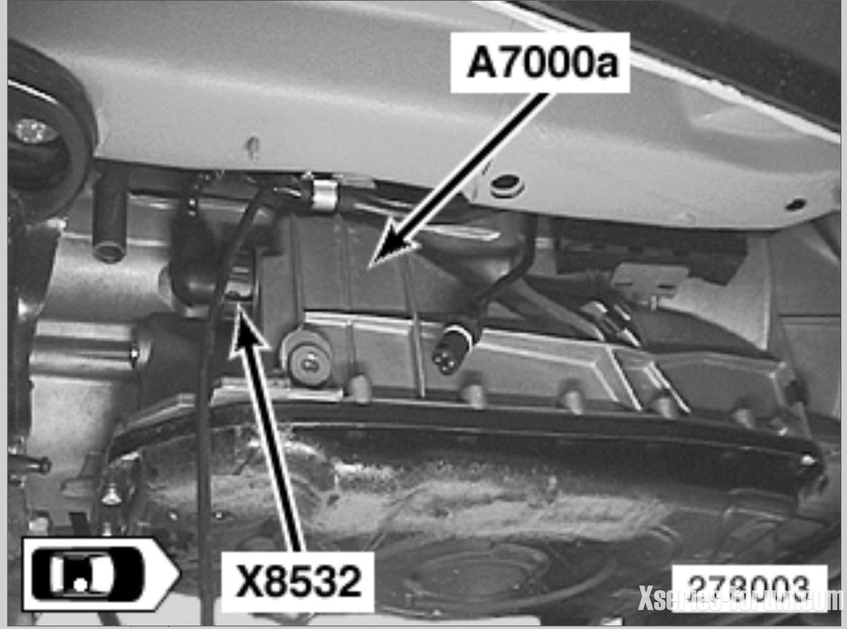

The technical manual says it is within the gearbox itself, right hand side. This is the only image I can find…A7000A
The automatic gearboxes 6HP19, 6HP26 and 6HP32 are mechatronic systems that unite both the mechanical system (gearbox) and the electronics (electronic transmission control ) within the gearbox housing. In the same way as automatic transmissions used to date, the adaptive electronic transmission control adapts the shift characteristics of the comfort program and sport program to the driver's choice and the driving situation.
The only other listed locations are in the electronics box under the bonnet, just ahead of the firewall.
Module A7000 (image may be from LHD so could be the other side on RHD).

OK, thanks. I won't be touching that then. I have an intermittent problem. Just driven 150km,no problems. Then 4x4 light comes on followed by Transfailsafe. Before, dealer changed the mechatronic socket. They said the transfer case was at fault. I've had that checked by a specialist, it works find. Actuator working fine and cog complete. Alternator changed (Bosch). New battery and SAS going on tomorrow. When the fault happens, it seems all CAN related. Did a live test, all speed sensors within 1km of each other. Only things left seem to be abs module, unless you've got any ideas please.
