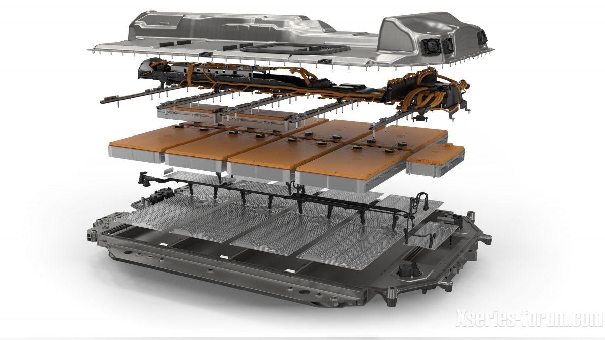

With regards to the battery packs, BMW have made theirs modular (unlike say Tesla) so if a single cell or module goes bad it’s replaceable. Modules will be a dealer/specialist replaceable part but cells will go back to the manufacturer. As owners, we would have a module replaced. The challenge with some manufacturers is they place all of the cells in one big pack, wire it together and fill it with foam. That makes it a complete swap job, rather than just a module. Tesla are repurposing old cells in their Powerwall System batteries that go with solar cells for home use. That decision by BMW looks to be future thinking around repairability. The main pack is just a big aluminium box that the parts fit into. The i4 has nine modules - seven under the floor and two in the ‘transmission tunnel’ for an ICE car - like this (an M50 so dual-motor):
I think as time goes on, specialists will spring up and it will be possible to get batteries swapped out. The same thing has happened with ICE cars after all - it just took time. Once the process is known and the hardware more readily available then this will become realistic. There are plenty of ‘damaged’ packs in specialist places that are fully repairable, the industry isn’t quite there yet, but it is coming.
There is a big question mark over warranty and then what? At present there aren’t enough cars out there that have hit much more than 10 years, or have and the batteries are cheaper because they’re much smaller - think Nissan Leaf or some of the Citroens. With some of those you lease the battery rather than own it, so it gets swapped out. The Chinese are looking at ‘hot swap’ garages where a pack is swapped out in minutes. For the i4 there are four coolant connections, 4 power connections and the CANbus etc, plus 22 large bolts! Unlike the i3 which uses ac refrigerant, the i4 coolant is normal coolant like we’re all used to, so no special handling. Refilling does need vacuum kit, but if hot swap becomes a reality then using auto close valuing can easily fix that.

I think it will take legislation to force batteries or modules to be easily swapped out by manufacturers , at present they are more than happy for them to be seen as a problem after the 8 years and help sell more new cars . :D
