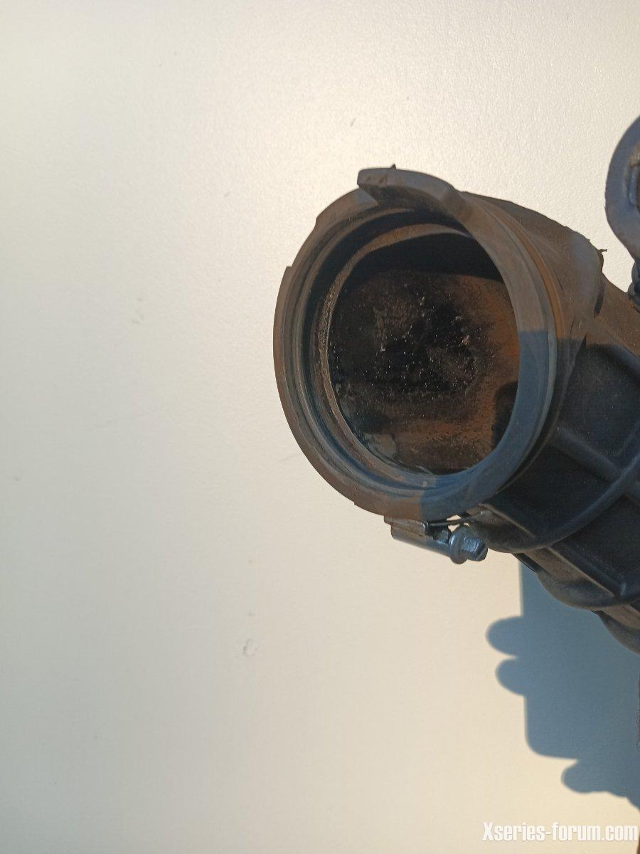

ImageTrying to get me 1st gen X 3 back on the road. M54 3.0. 234k on the clock

Look at what I discovered on the boot

Thanks for your help...I did remove the air intake to replace the starter...all went back easily.
Did you view the pic of the boot and the burn spot at the throttle body connection?
Any idea of what that's all about. I never smelled anything burning.
