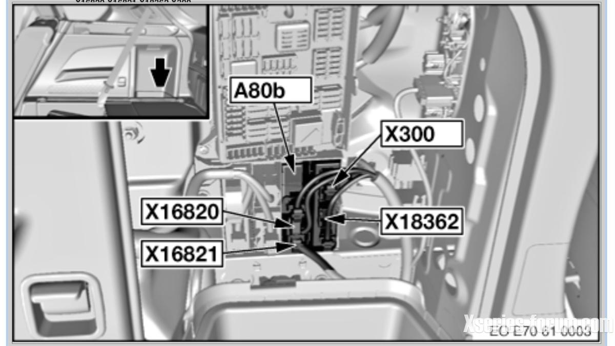

So ive had this come up on my info screen, DCC fault, Ive run the code reader and I now have these showing
6318 VDM activation line, left
D76A VDM rear left damper satellite
D768 VDM front left damper satellite
All came out of the blue, no handling issues

This help at all?
https://vroomo.co.uk/bmw-adaptive-m-sus ... explained/
The main suggestion seems to be to check all wiring connections for water ingress, damage or corrosion. All I can find looks to be E70 but there are major similarities to the E71. Diagnostics says to use ISTA so may need dealer help.
Check fuses F8 in the front and F106 in the rear, both are 7.5A. Wiring comes into module A80b (below right rear fuse box).
Left rear satellite is angled inboard and forward of the rear shock, front left is behind the wheel arch trim, left front.
Both have Pink & Green wires plus a Brown/Green wire into them and feed directly to the module above. Connectors are X18620 and X18621. Only the module A80b is common to both. Power goes directly from the fuses to the satellites. Module power is via fuse F120 (rear) 5A rated. The two connectors have all four satellite modules coming into them (left and right corners).
