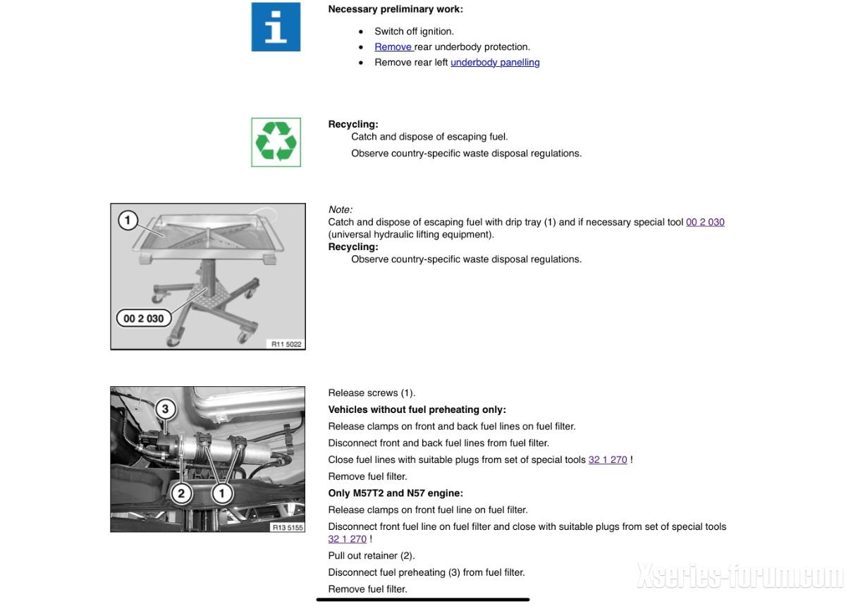

Would it be this part?
https://www.realoem.com/bmw/enUS/showpa ... Id=13_1230
Comes with a fuel strainer. I suppose I'd better get one just in case we get a freak winter.
Posts: 19167
Fuel filter heater control
Post by X5Sport » Wed Jun 29, 2022 6:38 pm
Have a look underneath to be certain (or check with a dealer parts team - then order elsewhere to get it cheaper).
